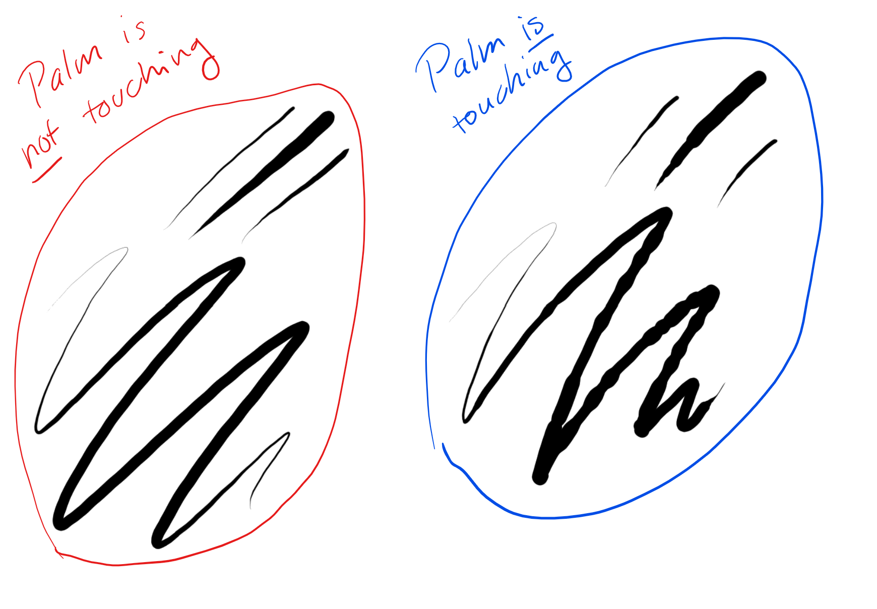

Pen works fine when only the pen is making contact with the screen. However, when my palm is resting on the screen, the pressure detection of the pen becomes extremely inaccurate. As soon as skin (palm, fingers, etc) makes contact with the screen, the pressure curve of the pen becomes a staircase, as if the pen could only detect 5-20 levels of pressure, instead of 4096 like it's supposed to. Here's a screenshot from the Surface app:![](https://learn-attachment.microsoft.com/api/attachments/cdc3b0c5-bfcc-4409-b0a1-318885287f48?platform=QnAAnd here is how it looks like when drawing:
Is this normal? How can I fix it?

    Thanks for your reply! I ran the Diagnostic Tool again now just to be sure. Just like before, it didn't find anything.
    From Device Manager, I uninstalled almost all HID devices just to be sure, not just ones that said touch/pen/ink. It started adding them back after I had uninstalled almost everything. I rebooted. The problem still persists.
    Anything else I could try?
    2019-11-05T16:55:01+00:00
    I really appreciate the efforts. Is this happening both when PSU is plugged in and on battery? To reproduce the issue, can you sit the device on your lap and try to write without accessories connected except for your Surface Pen? If issue persist, try to change the battery with a brand new one. Other way to isolate is test another brand new pen on your Surface or test your Pen on a different Surface.
    2019-11-05T21:20:59+00:00
    I am also having the same problem and using the exact same pen with my surface pro 6 i'm not getting the same problem.
    I also use the Tablet Pro pen tool (I'm one of the developers of the app) and the hid events are going wild. you can test with the pen tool, choose settings and custom pen and display hid events. This makes it really clear that something very different is going on with the surface pro 7 and how it reads the pen.
    I personally own 6 different stylus (5 different brands) and 4 different surface devices (book 2, surface go, sp6 and sp7) the Surface Pro 7 is the only device that has this problem.
    I can confirm that ALL the stylus are getting the same stepping behavior. tested new surface pen, yobwin, wacom bamboo ink, a second new surface pen (grey and black) and raphael 5 stylus.
    please feel free to email or contact me directly. ******@tabletpro.com
    2019-11-05T21:22:16+00:00
    I also should mention that I have owned 5 and tested this on 4 different surface pro 7 devices (2 i5 and 2 i7 models) and all have the same problem.
