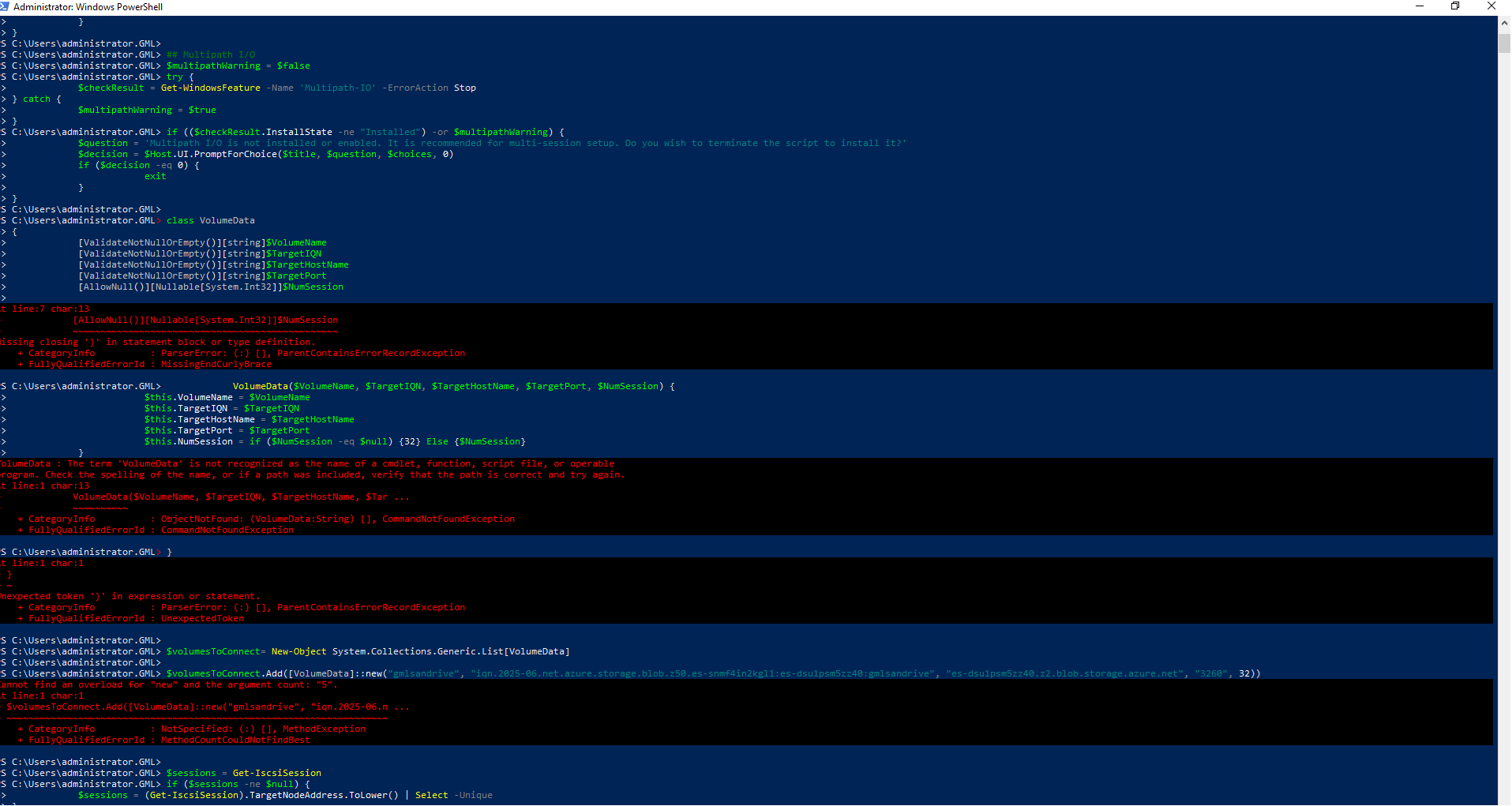

i have purchased and crate Azure Elastic San, but it does not connect to the volume and shows following error,
please help me to fix this error and connect the volume
This is the error message
PS C:\Users\administrator.GML> # Check dependency
PS C:\Users\administrator.GML> $title    = 'Confirm'
PS C:\Users\administrator.GML> $choices = @(
             [System.Management.Automation.Host.ChoiceDescription]::new("&Yes to terminate", "Yes to terminate")
             [System.Management.Automation.Host.ChoiceDescription]::new("&No to proceed with rest of the steps", "No to proceed with rest of the steps")
PS C:\Users\administrator.GML> ## iSCSI initiator
PS C:\Users\administrator.GML> $iscsiWarning = $false
PS C:\Users\administrator.GML> try {
             $checkResult = Get-Service -Name MSiSCSI -ErrorAction Stop
} catch {
             $iscsiWarning = $true
PS C:\Users\administrator.GML> if (($checkResult.Status -ne "Running") -or $iscsiWarning) {
             $question = 'iSCSI initiator is not installed or enabled. It is required for successful execution of this connect script. Do you wish to terminate the script to install it?'
             $decision = $Host.UI.PromptForChoice($title, $question, $choices, 0)
             if ($decision -eq 0) {
                         exit
PS C:\Users\administrator.GML> ## Multipath I/O
PS C:\Users\administrator.GML> $multipathWarning = $false
             $checkResult = Get-WindowsFeature -Name 'Multipath-IO' -ErrorAction Stop
} catch {
             $multipathWarning = $true
PS C:\Users\administrator.GML> if (($checkResult.InstallState -ne "Installed") -or $multipathWarning) {
             $question = 'Multipath I/O is not installed or enabled. It is recommended for multi-session setup. Do you wish to terminate the script to install it?'
                         exit
PS C:\Users\administrator.GML> class VolumeData
             [ValidateNotNullOrEmpty()][string]$VolumeName
             [ValidateNotNullOrEmpty()][string]$TargetIQN
             [ValidateNotNullOrEmpty()][string]$TargetHostName
             [ValidateNotNullOrEmpty()][string]$TargetPort
             [AllowNull()][Nullable[System.Int32]]$NumSession
At line:7 char:13
+             [AllowNull()][Nullable[System.Int32]]$NumSession
Missing closing '}' in statement block or type definition.
    + CategoryInfo          : ParserError: (:) [], ParentContainsErrorRecordException
    + FullyQualifiedErrorId : MissingEndCurlyBrace
PS C:\Users\administrator.GML>             VolumeData($VolumeName, $TargetIQN, $TargetHostName, $TargetPort, $NumSession) {
                         $this.VolumeName = $VolumeName
                         $this.TargetIQN = $TargetIQN
                         $this.TargetHostName = $TargetHostName
                         $this.TargetPort = $TargetPort
                         $this.NumSession = if ($NumSession -eq $null) {32} Else {$NumSession}
VolumeData : The term 'VolumeData' is not recognized as the name of a cmdlet, function, script file, or operable
program. Check the spelling of the name, or if a path was included, verify that the path is correct and try again.
At line:1 char:13
+             VolumeData($VolumeName, $TargetIQN, $TargetHostName, $Tar ...
    + CategoryInfo          : ObjectNotFound: (VolumeData:String) [], CommandNotFoundException
    + FullyQualifiedErrorId : CommandNotFoundException
PS C:\Users\administrator.GML> }
At line:1 char:1
Unexpected token '}' in expression or statement.
    + FullyQualifiedErrorId : UnexpectedToken
PS C:\Users\administrator.GML> $volumesToConnect= New-Object System.Collections.Generic.List[VolumeData]
New-Object : Cannot find type [System.Collections.Generic.List[VolumeData]]: verify that the assembly containing this
type is loaded.
At line:1 char:20
... umesToConnect= New-Object System.Collections.Generic.List[VolumeData]
    + CategoryInfo          : InvalidType: (:) [New-Object], PSArgumentException
    + FullyQualifiedErrorId : TypeNotFound,Microsoft.PowerShell.Commands.NewObjectCommand
PS C:\Users\administrator.GML> $volumesToConnect.Add([VolumeData]::new("gmlazuresan", "iqn.2025-06.net.azure.storage.blob.z44.es-kyy40uuntgu1:es-xryflrsftew0:gmlazuresan", "es-xryflrsftew0.z16.blob.storage.azure.net", "3260", 32))
Unable to find type [VolumeData].
At line:1 char:23
$volumesToConnect.Add([VolumeData]::new("gmlazuresan", "iqn.2025-06.n ...
    + CategoryInfo          : InvalidOperation: (VolumeData:TypeName) [], RuntimeException
PS C:\Users\administrator.GML> $sessions = Get-IscsiSession
PS C:\Users\administrator.GML> if ($sessions -ne $null) {
             $sessions = (Get-IscsiSession).TargetNodeAddress.ToLower() | Select -Unique
PS C:\Users\administrator.GML> # Modify the max login retries per session if necessary
PS C:\Users\administrator.GML> $maxLoginRetriesPerSession = 5
PS C:\Users\administrator.GML> foreach($volume in $volumesToConnect) {
             # Check if the volume is already connected
             if ($sessions -ne $null -and $sessions.Contains($volume.TargetIQN.ToLower())) {
                         Write-Host $volume.VolumeName [$($volume.TargetIQN)]: Skipped as this volume is already connected -ForegroundColor Magenta
                         continue
             # Connect volume
             Write-Host $volume.VolumeName [$($volume.TargetIQN)]: Connecting to this volume -ForegroundColor Cyan
             iscsicli AddTarget $volume.TargetIQN * $volume.TargetHostName $volume.TargetPort * 0 * * * * * * * * * 0
             $LoginOptions = '0x00000002'
             for ($i = 0; $i -lt $volume.NumSession; $i++) {
                         iscsicli PersistentLoginTarget $volume.TargetIQN.ToLower() t $volume.TargetHostname.ToLower() $volume.TargetPort Root\ISCSIPRT\0000_0 -1 * $LoginOptions 1 1 * * * * * * * 0
                         $loginAttempts = 0
                         do {
                                     iscsicli LoginTarget $volume.TargetIQN t $volume.TargetHostName $volume.TargetPort Root\ISCSIPRT\0000_0 -1 * $LoginOptions 1 1 * * * * * * * 0
                                     $loginAttempts += 1
                         } while (($LASTEXITCODE -ne 0) -and ($loginAttempts -lt $maxLoginRetriesPerSession))
This is the Script i have run, (Copy from the Azure)

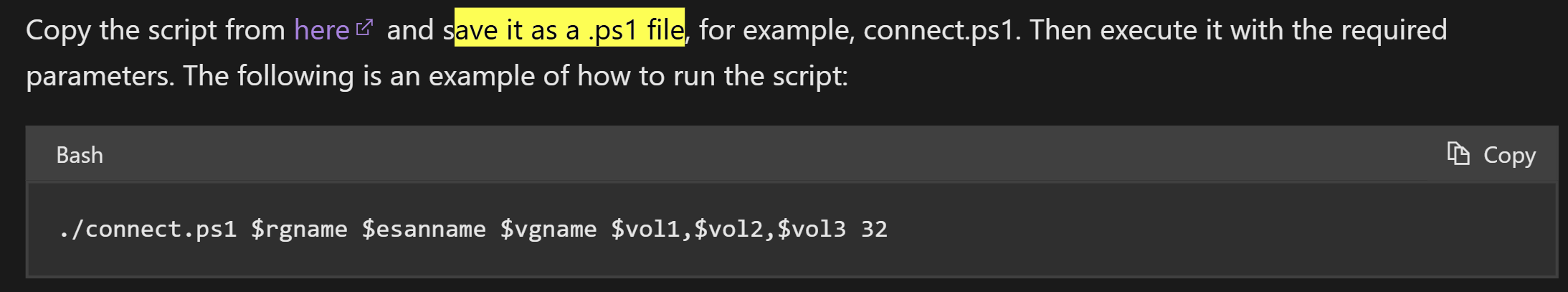

    Sure, please double check and make sure that you are following the below script to create your connections. So, here to execute the script, you require the following parameters.
    • $rgname: Resource Group Name
    • $esanname: Elastic SAN Name
    • $vgname: Volume Group Name
    • $vol1: First Volume Name
    • $vol2: Second Volume Name and other volume names that you might require
    • 32: Number of sessions to each volume
    From the document here you copy the sample script and save it as a .ps1 file, for example, connect.ps1. Then execute it with the required parameters. The following is an example of how to run the script:
    BashCopy
    ./connect.ps1 $rgname $esanname $vgname $vol1,$vol2,$vol3 32
    Verify the number of sessions your volume has with either iscsicli SessionList or mpclaim -s -d.
    Later, please make sure you use 32 sessions to each target volume to achieve its maximum IOPS and/or throughput limits. Windows iSCSI initiator has a limit of maximum 256 sessions. If you would like to connect more than 8 volumes to a Windows client, reduce the number of sessions to each volume.
    You can customize the number of sessions by using the optional -NumSession parameter when running the connect.ps1 script.
