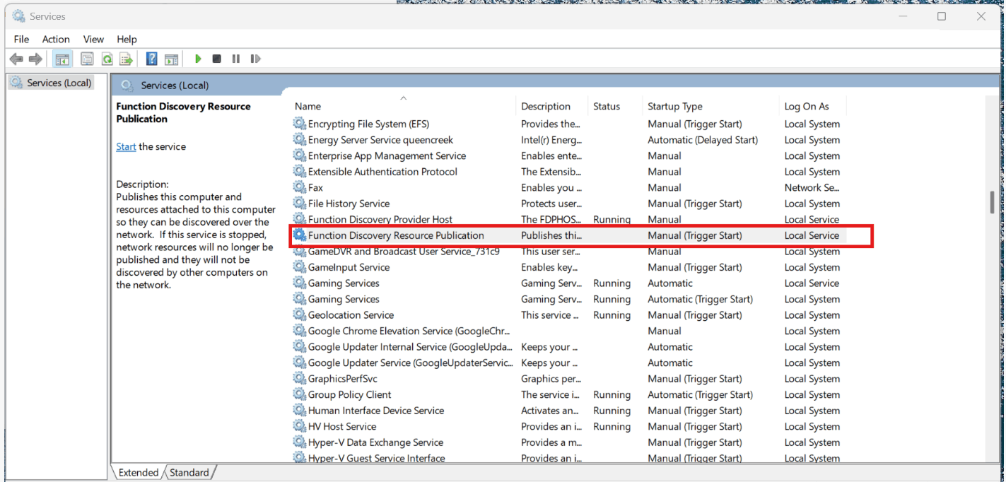

    Here is another difference I found on some machines with 24H2.
    A) One 24H2 machine had this service set for Manual (Trigger Start) and the service never even started, it does not show Running.
    Without the service Running the PC will not show up at all on the network on any PC.

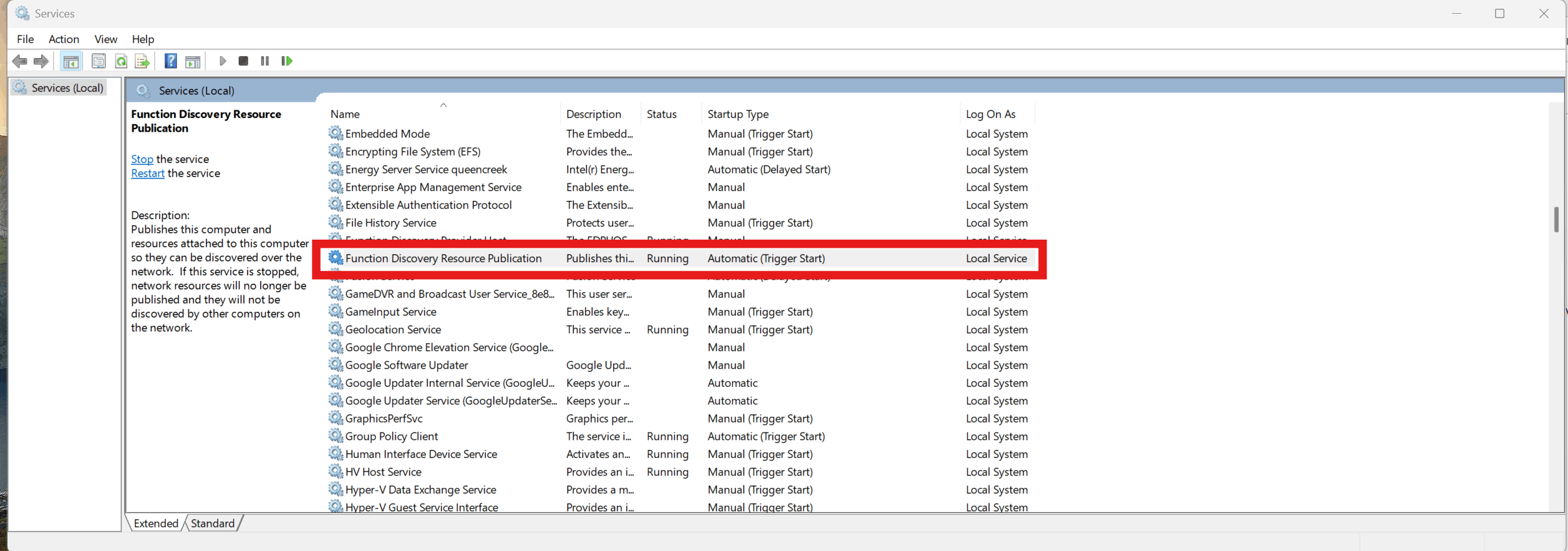

    B) This other 24H2 machine at the same Build level has this service set for Automatic (Trigger Start) and it shows Running.
    The difference is:
    A) In case A the PC will not show anywhere unless you start the service.
    B) In case B the PC shows up on all the other PCs on the network but not on the local PC unless the service is restarted. πŸ€πŸ˜œπŸ€·β€β™‚οΈ
    Anyway, looks like they have a bug when using Manual (Trigger Start) the trigger is not working and the service does not start. 🀬
